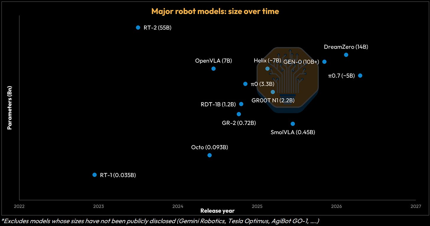

This is why frontier robot models remain far smaller than frontier LLMs, which have already pushed into the trillions of parameters. Today most frontier robot models sit between roughly 5 and 14 billion parameters: Physical Intelligence’s π0.7 at 5 billion, and NVIDIA’s DreamZero at 14 billion.

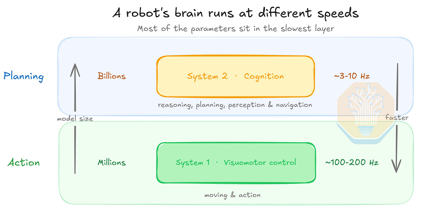

Even within data-driven generalist robot models, architectures vary. Some are monolithic: one model that goes straight from what the camera sees to how the motors move. Many are hierarchical: a big, slow model decides what to do, and a small, fast one turns that into movement, hundreds of times a second. Our argument for off-robot datacenter compute is about these hierarchical models, where the brain separates into two or more layers, most often a planning layer and an action layer.
The planning layer is the slow, high-level one: it perceives the scene, reasons about space, and plans the task. The action layer is the fast, low-level one: it turns those plans into motor commands. The planning layer, which is also the heavy part of the model, is the more forgiving: it updates only a few times a second and runs asynchronously from the control loop, so the action layer keeps acting on the most recent plan while the next one is still in flight. That decoupling lets planning absorb the delay, and even the jitter, of a wireless round trip, while the action layer runs at hundreds of Hz and can tolerate none of it. So planning is the natural candidate to move into the datacenter, while the fast control loop stays local.

The amount of planning scales with how general the robot’s job is. A generalist built to handle open-ended tasks needs a large planning model doing genuine reasoning, and those models are heavy. That reasoning is exactly what gets pushed to the datacenter. A specialist is the opposite case: a narrow policy doing one repetitive job carries little high-level planning, so the whole model is small enough to stay on the robot.

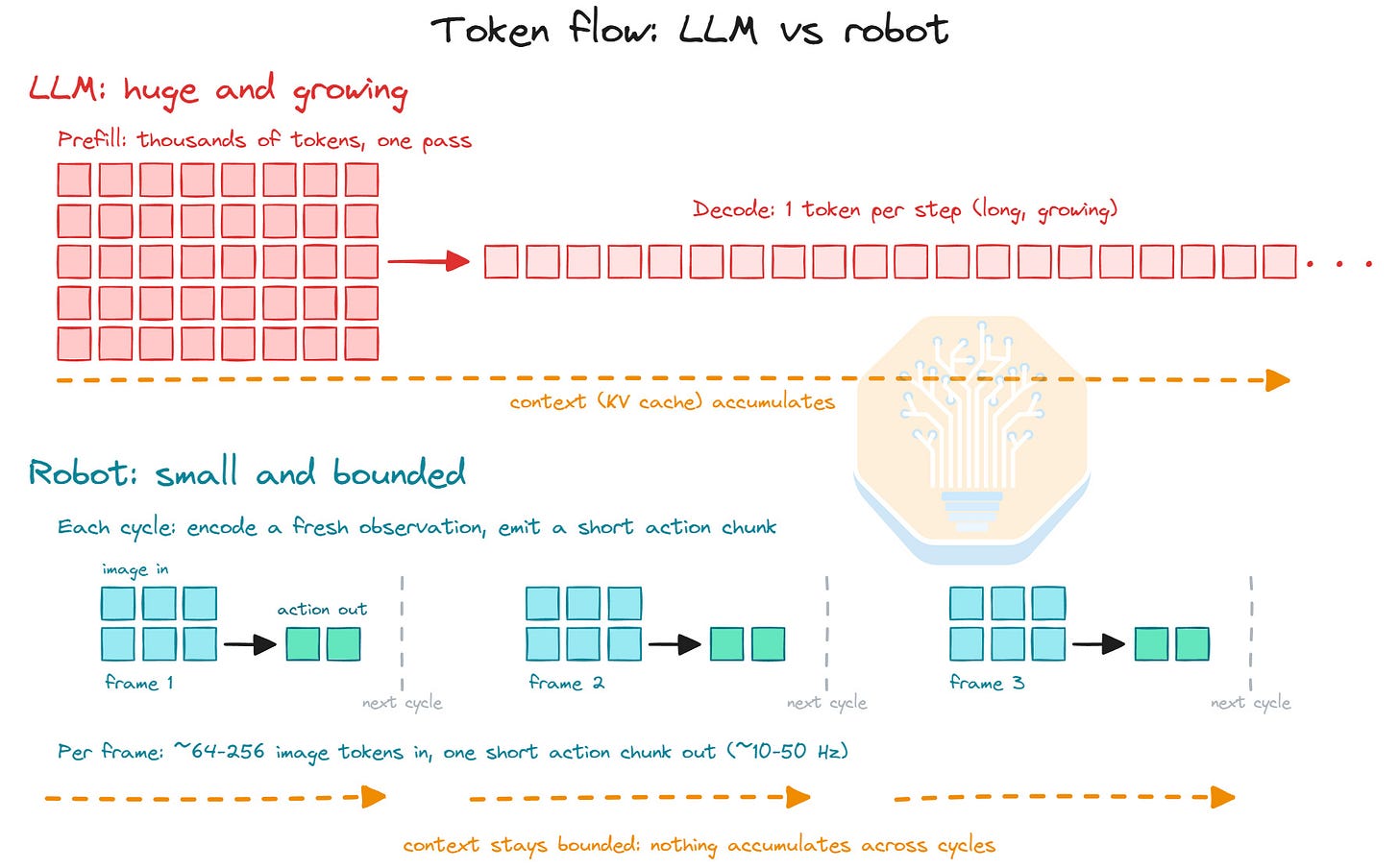

An LLM ingests and emits huge, bursty token counts: a long prompt to prefill, then a long generation, with a KV cache that grows the whole time. That is the memory wall, the capacity to hold that cache and the bandwidth to stream the weights and cache on every token, and it makes LLM serving bandwidth-bound.
A robot model is the opposite, a smaller steady stream, more metronome-like rather than a burst. It never stops, because a robot is not answering one question and halting; it is locked in a closed loop with a moving world, taking in a fresh frame and emitting a short action chunk a few times a second. Each frame is compressed in dedicated hardware (the ISP and video-codec ASICs) into a fixed, compact token budget of tens to a few hundred tokens. So robot models are not as memory capacity and bandwidth bound in the same way that LLMs are.

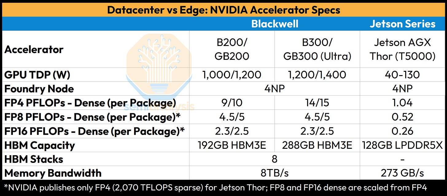

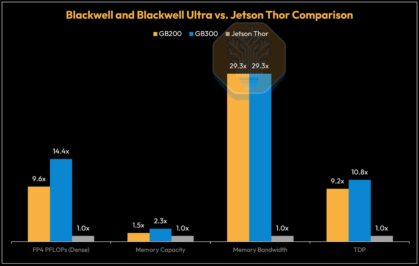

Edge silicon cannot keep up. Nvidia’s latest Jetson Thor, the best-in-class robot brain, has only about a tenth of a single B200’s compute, and roughly a fourteenth of a B300’s. DreamZero (a 14B WAM) needed two GB200 GPUs just to reach ~7Hz, which is on the order of twenty times the compute a single Thor can muster. Run the same model on a Thor and it would fall to a fraction of 1Hz, far too slow for real-time control.

If a Jetson Thor can’t keep up, and we off-load the heavy, compute-intensive part of the workload to datacenters, it means optimizing local compute for safety loops and high-frequency control loops, and doubling-down on network interfacing.

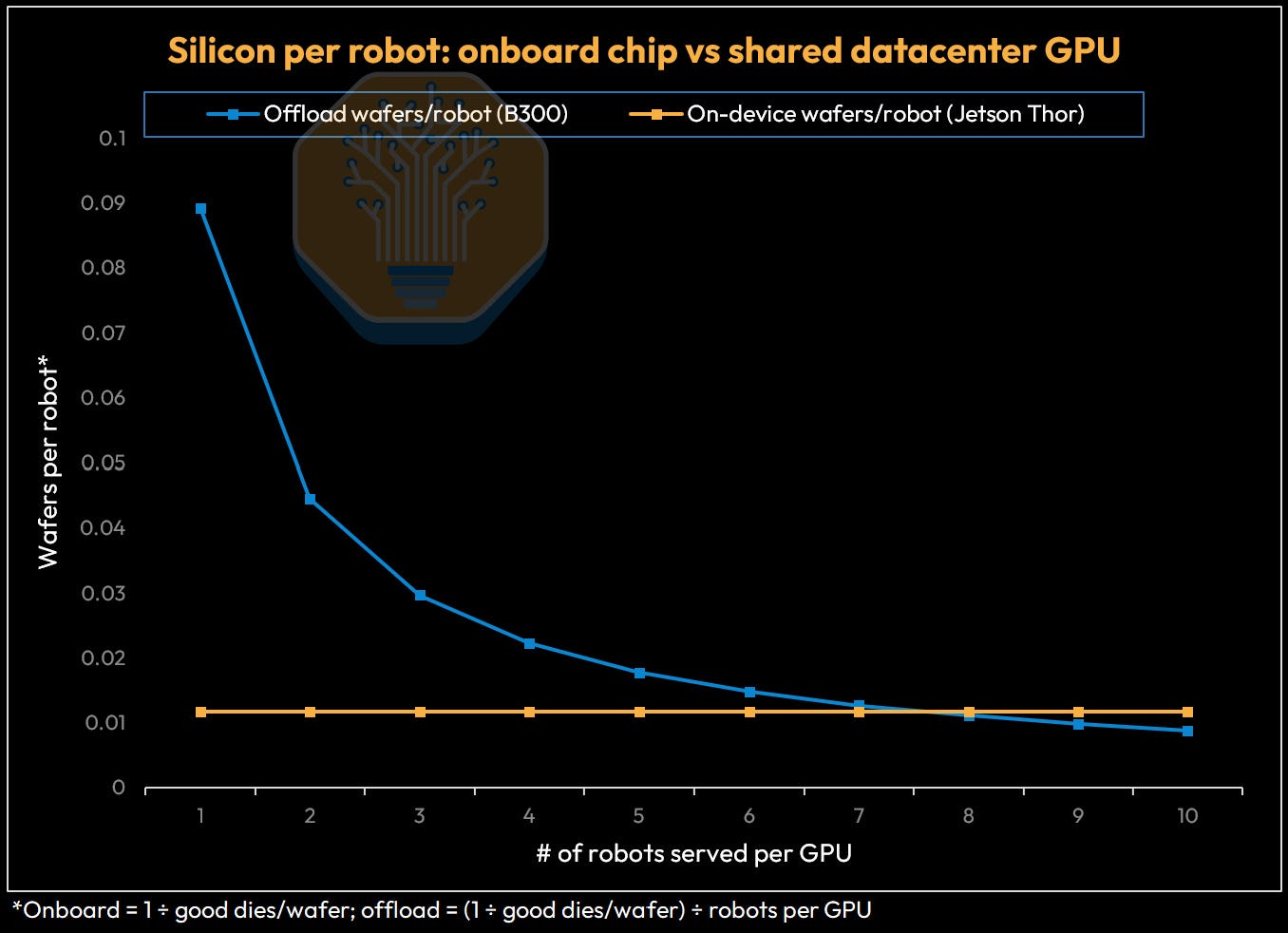

But the wafer demand from robots is not where the strain is. A million Jetson-class chips in 2030, each around 400mm², is only about ten thousand wafers for the year, a rounding error next to the datacenter GPU ramp, because Thor’s die is barely half a reticle size chip, and there simply aren’t many robots yet. Supply only tightens once robots need tens of millions of chips a year, well beyond 2030. So the real question is not whether robots can get wafers. It is silicon efficiency: for a given fleet of robots, which approach consumes less leading-edge silicon? Putting a chip in every robot, or serving their cognition from shared datacenter GPUs.
If you look at silicon efficiency as wafers per robot, the onboard chip and the shared datacenter GPU cross over at around 7 robots per GPU. Beyond that, serving cognition from a shared GPU takes less silicon per robot than putting a chip in every machine. And that’s what really matters here, because when fab supply is scarce, the approach that uses less silicon per robot is the one that scales.

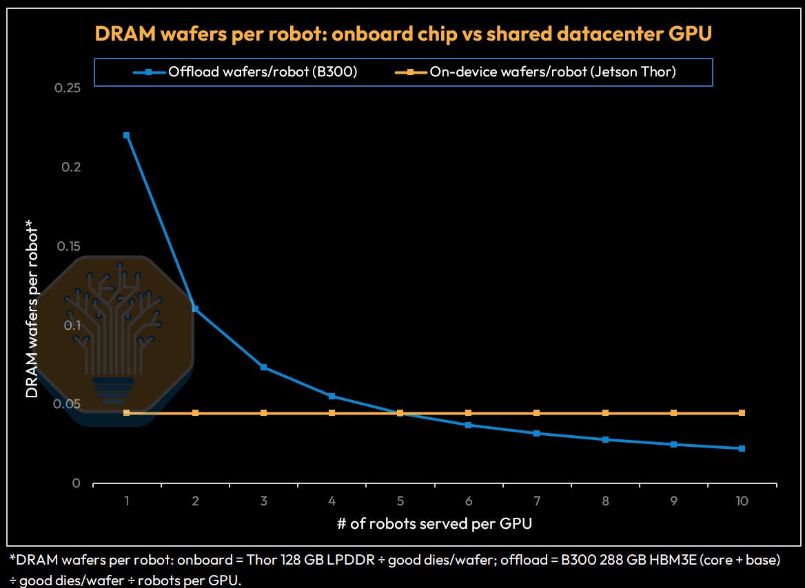

Another major bottleneck is memory. Each Jetson generation has carried more DRAM than the last: Jetson Xavier used 32GB, AGX Orin 64GB, and Jetson Thor now uses 128GB of LPDDR5X, with future generations set to keep climbing. Although total DRAM wafer capacity continues to grow, most of the incremental capacity is being absorbed by HBM for AI accelerators.
That leaves the commodity and LPDDR supply that robot brains depend on competing for a shrinking pool of non-HBM wafers. Similarly, when DRAM is the scarce resource, the approach that uses less DRAM per robot is the one that scales. The LPDDR is better off being allocated to Vera GPUs or wafers to HBM.
Memory tells a similar story, the onboard chip and the shared datacenter GPU cross over at around 5 robots per GPU. Beyond that, serving cognition from a shared GPU takes less DRAM per robot than putting a chip in every machine.

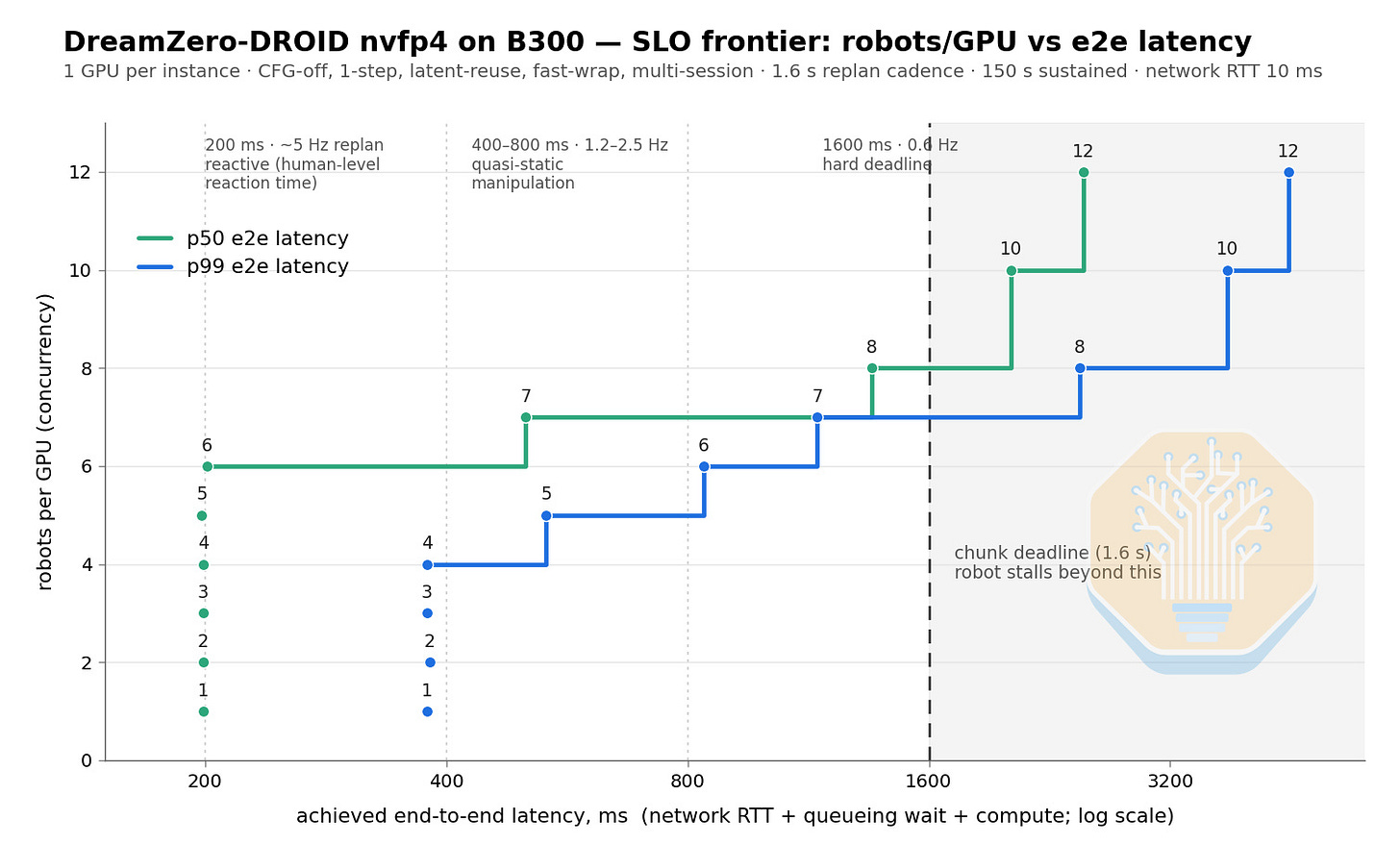

We ran DreamZero, current leader on RoboArena, on a real B300, using the inference optimizations from NVIDIA’s WAM paper (CUDA graphs, DiT caching, NVFP4 quantization, moving the scheduler onto the GPU). We also ran a single denoising step to match the DreamZero-Flash setup, though without Flash’s retraining recipe, so task quality is unvalidated.
DreamZero’s serving profile is prefill-shaped: each inference pushes a full chunk of video latents (thousands of tokens) through the 14B DiT in parallel, so a B300 is compute-bound at batch size 1. Batching therefore buys nothing: FLOPs scale one-for-one with batch size, and every robot just waits longer. Instead, we time-multiplex, with the B300 serving each robot sequentially. This is specific to video-generating WAMs. A VLA like π0 or GR00T flips the roofline: a few hundred tokens through a small backbone leaves the GPU memory-bandwidth-bound, so batching amortizes the same weight reads across robots and throughput scales nearly linearly with batch size. Serve a VLA fleet with continuous batching; serve a video WAM one robot at a time.
A key assumption we made is that Network RTT is 10ms, meaning the GPU sits on-prem near the robots. Each inference buys the robot its next 1.6 seconds of motion, which makes 1.6 seconds our latency budget: the total time a request gets to spend across network, queueing, and compute before the robot runs out of instructions and stalls mid-motion.
We read the chart below on p99 latency (blue line), the 99th percentile response time. 99 out of 100 requests come back faster than this, so it’s effectively the worst case. It matters more than the median (green line) here because a robot stalls the moment any single chunk shows up late. We see that the maximum number of robots we can process on 1 B300 GPU is 7 robots. At 7 robots, p99 is 1.16 seconds, still under the wall, with zero missed chunks over the run.

Now that we know we can time-multiplex 7 robots per GPU, the fundamental TCO question stands:
We build up two scenarios: the offload scenario assumes one Blackwell-class server which can serve 7 robots (i.e. one B300 NVL8 server serving 56 robots), and an on-robot scenario of the same 56 robots each carrying its own Jetson Thor. In both scenarios, common parts across both cases (i.e. mechanical components, robot shells) are not included in the BOM cost calculation.
